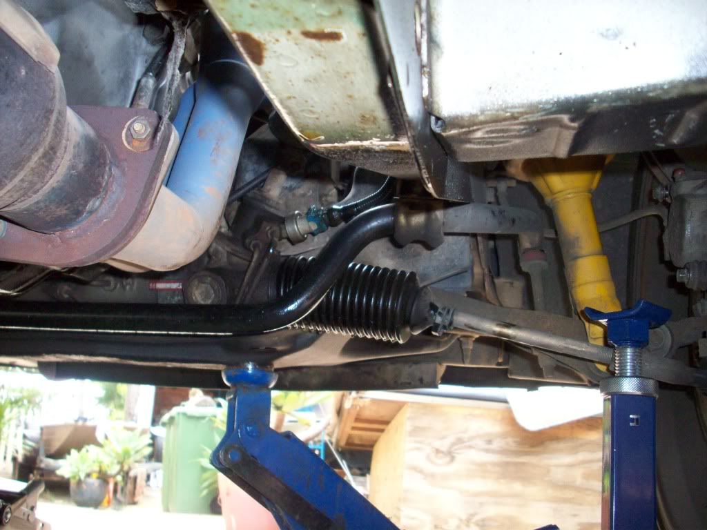

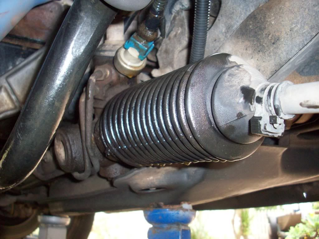

so like i have a power steering leak. which i have not yet done anything about..
seal in the steering rack? the oil pressure sender thing? im not totally sure on this one... ?
i have pics though :D
note at the top of this pic the oil is on the frame of the car, look upppp lol..
how does it get there?
leaking like a pregnant woman
and the supervisor at work
so yeah im not sure what ill have to replace? as im sick of replacing fluid every day lol.

looks like its coming out of the switch on the rack

yep, i'd say the switch too. is there excess movement/play in teh rack

i had the same problem ages ago, it was the steering pressure switch.
about a ten second job to replace.

just pull it out and put some teflon on it or some gasket gue ;)

yeh definitely looks like the switch, they normally leak through so you cant reseal them, and are cheap to replace

and nay try puting the stand under a better place then that coz where that is now wont save u if the car falls :shock:

alright ill give bursons a call tomorrow, whats the part pretty much called? the power steering oil pressure switch?
lol.
and yeah trav, i only moved it so i could get in there to take the photo.. :P
