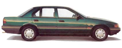

EB Falcon Photos (photos are cropped, click to enlarge)
Ford EB Falcon
On Sale: July 1991 - August 1993 (Series II: April 1992)
How do I know it's an EB? Slight changes over EA include: Ford badge positioned in grille, no air vent in C-pillars, side indicators, new wheel trims and reverse lights on either side of number plate.
Series II: Glossy door handles, 4.0L badges on 6 cylinder models, and body-coloured bumpers for the base model.
